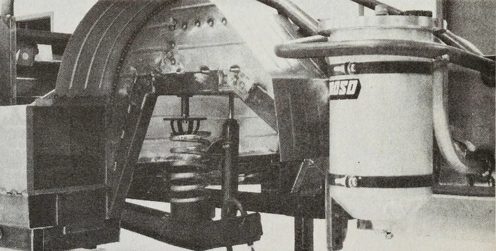

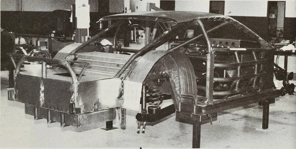

As always with these projects what you think was the correct dimensions were not. I had to reduce the size of the tank from front to rear and also make it less deep. I just need to add the reinforcement straps and install a wall that will be even with the front of it in the compartment where the axle is mounted. I also realized from  new ref photos I found that the truck arms are not straight but have a bend right before where they attach to the axle with u bolts.
the two photos show the bend right after where the spring is mounted on the arm I will need to redo that.
Got the tank finished. Now just have to redo the truck arms .
