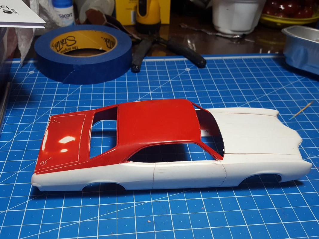

I painted the sides of the test body with Tamiya white primer and will shoot Createx Wicked red on one side and plain old Createx wicked gold on the other side. Luckily, I found a bottle of it in my stash that had not separated out from age. It appears to be more metallic than the pearl gold I used the first time. If it looks good, I will start preparing the Monte Carlo body for paint.
Got the test body ready for paint today. I will paint one side red and the other side metallic gold to see if I like it better than pearl gold. I might end up mixing the pearl gold with the metallic gold. That's the beauty of a test body. I originally had the test body primer gray, but I switched to Tamiya white primer in the can.
Had to clean the airbrush and came up with a system using paper towel and black sharpie to keep everything in order so I don't get lost putting it back together like the first time I cleaned this trigger style air brush. It has a lot more parts than the plunger type airbrush. I used the wicked gold on white primer on the right side of the test body and it came out much better than the wicked pearl gold on gray primer did. I also liked the wicked red and will use both of them on the Monte Carlo body.

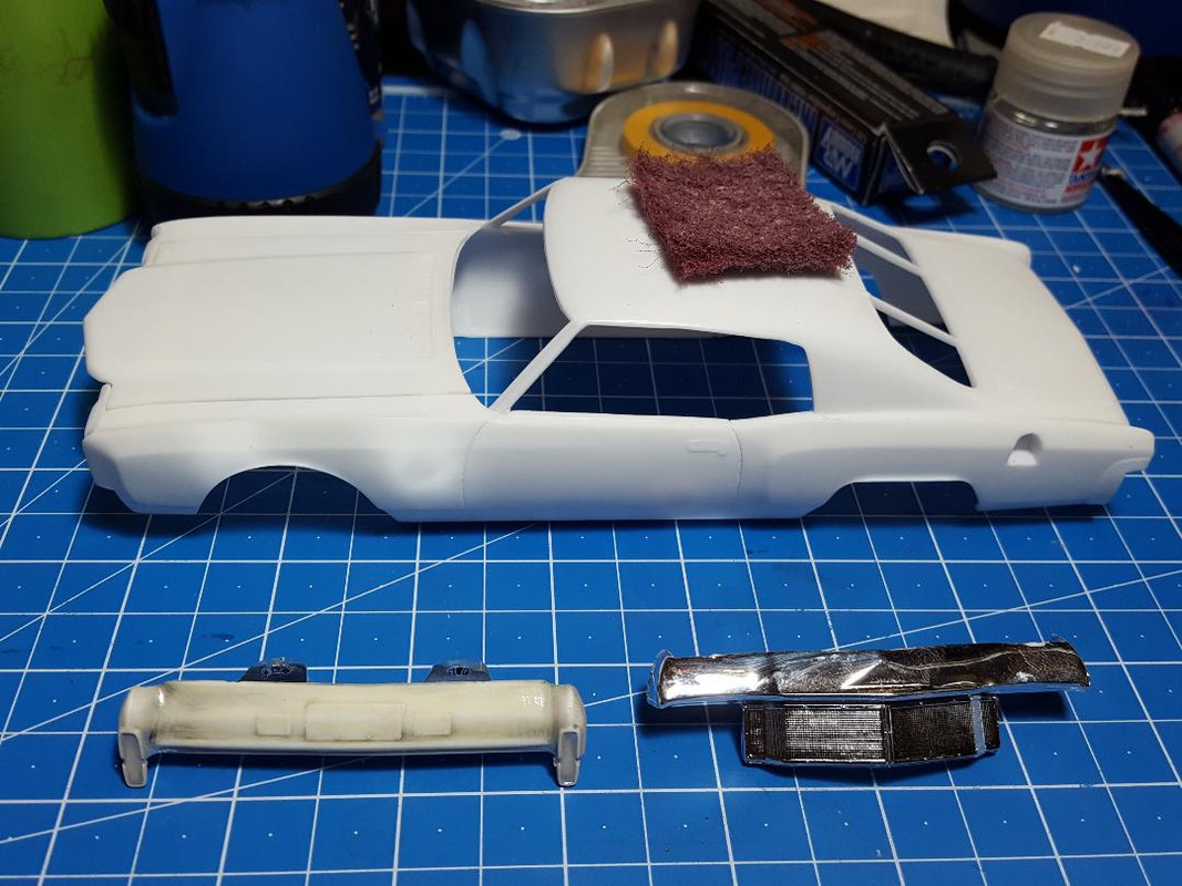

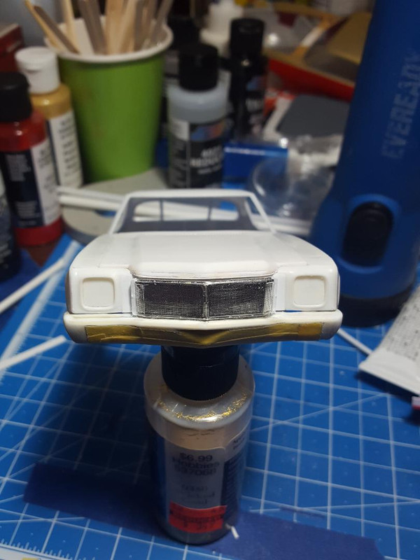

Got some more work done. Had to shore up the gap at the hood to grille. Poor engineering by the model company.

Did some more work getting rid of gaps at the front and finished the fairing at the quarter glasses.
