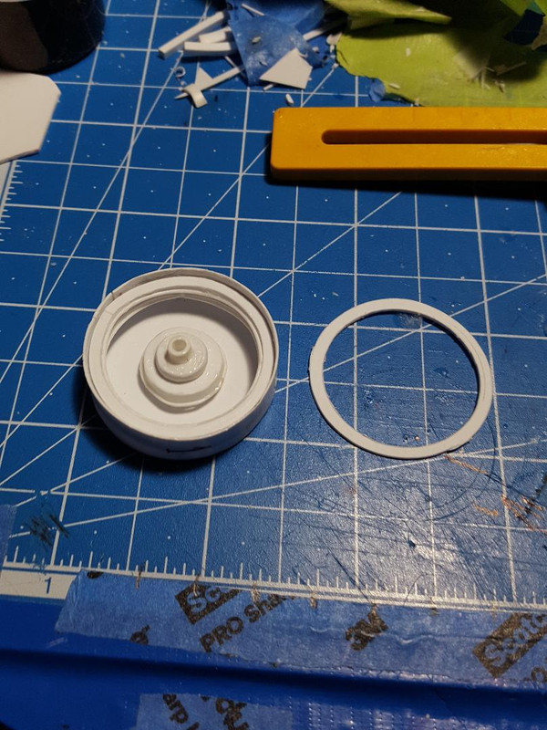

Thanks, Steve. What you see here is the inside and outside of the tire. I will make an inner and outer belt to connect the two of them so the tire will actually be hollow. I will strengthen the sides with rods put through the discs and then put a framework on them to fill with epoxy putty. I will sand that down to make the tires round on the outside. It will all come clear eventually how I'm going to do it.
I thought I would need to add the little wedge pieces to the sides of the tire, but that work is such a time waster that I believe all I need is the radius wall in the middle of the sides of the tire to fill in with epoxy putty. I will scoop it in place with a plastic spoon.

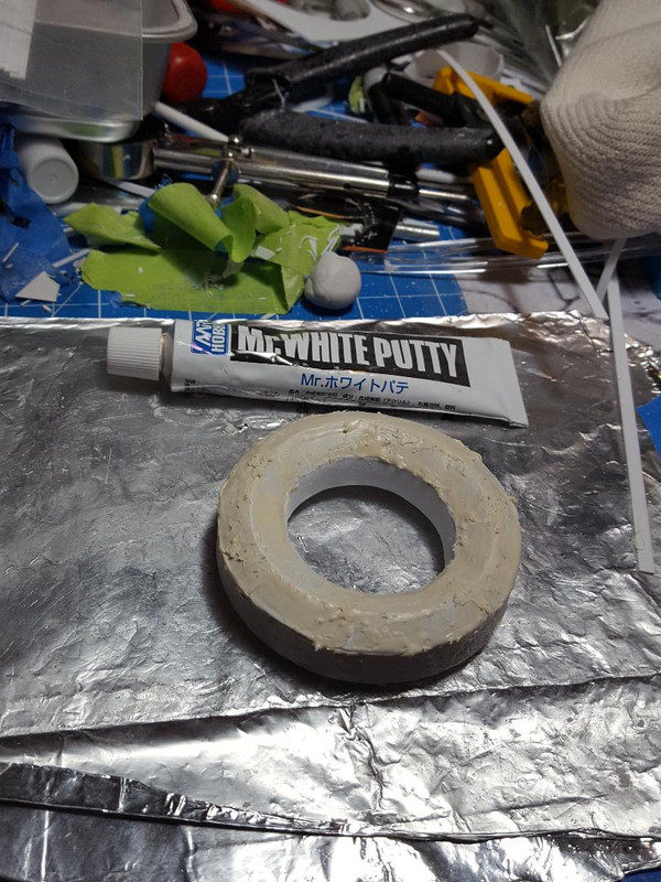

Very happy with the epoxy putty. It cures very hard and is easy to smooth out with a Dremel type tool using a cylinder-shaped course sanding tube. What I have so far looks like a tire and wheel. After painted it wont even look plastic anymore.
Got both sides of the first tire done. Just need to add some regular putty to get the sides totally smooth and add some tread to the surface of the tire using a rasp file. Will roll the tire over the file to leave the imprint of the file that will simulate tire tread.

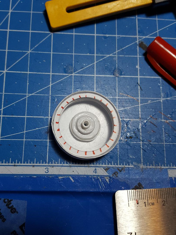

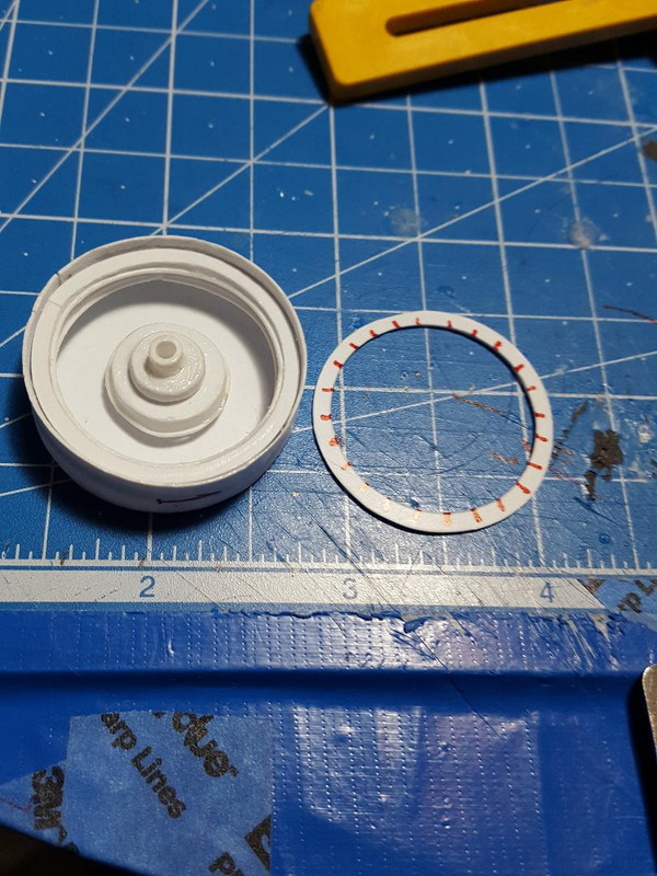

Added Mr. white putty to the top of the epoxy putty to smooth it out more. Made a ring with markings on it to show me where to put the spokes when I get back to spoking the wheels. Doing it this way keeps me from having to mark each wheel and then have to sand off the markings which is wasted time work. I have decided to make the other 3 tires first before finishing the spoking of the wheels.
