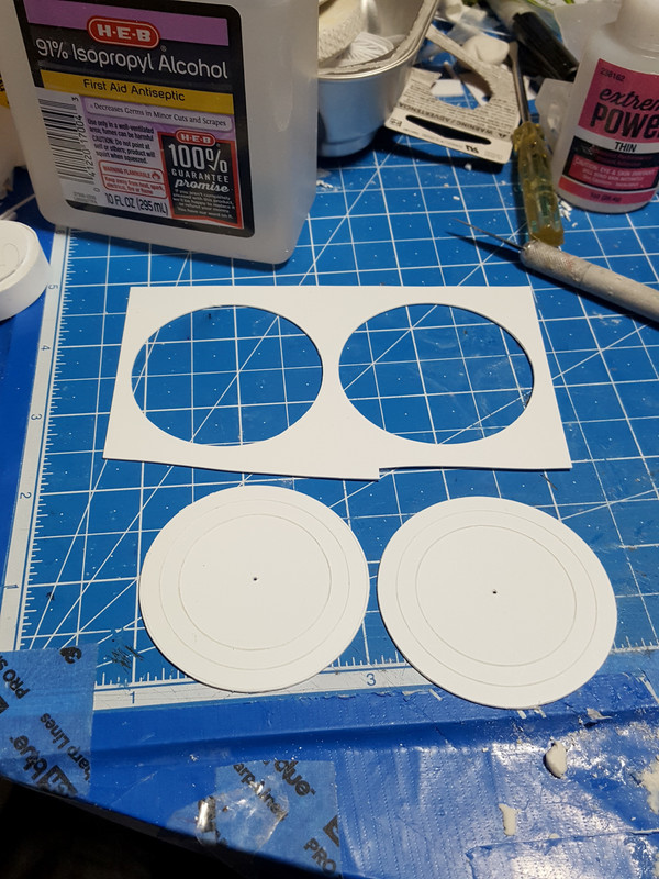

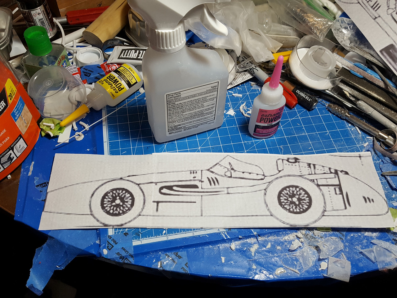

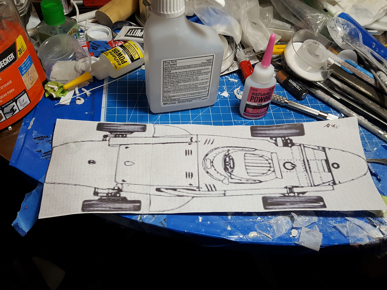

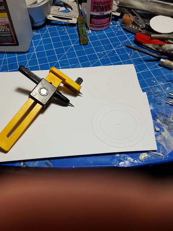

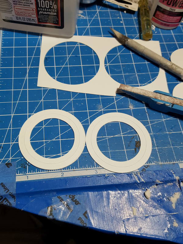

Here are the plans I will be using to get all the dimensions I need to build the model. It will be 1/12 scale. I began building the first front tire.
