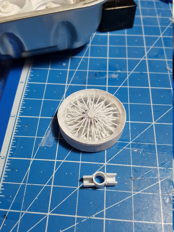

Finally got the spokes done on the right rear wheel. I cleaned it up a bit and now I need to make 4 knock off hubs that all look the same. The beginning of the first one is pictured below with the wheel.
