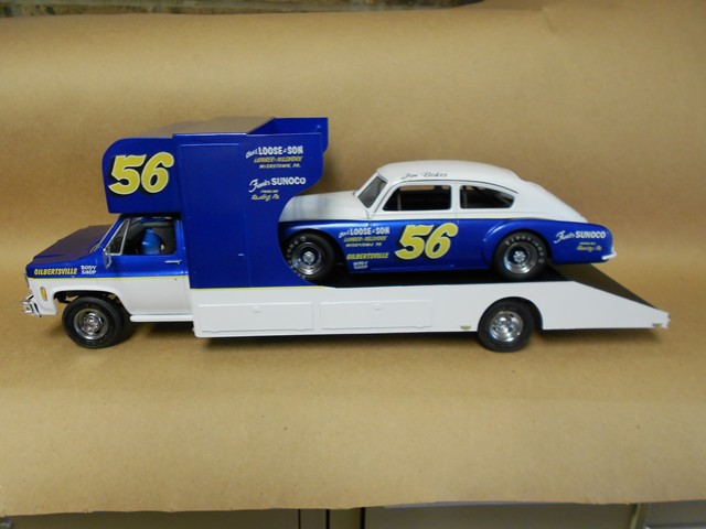

Hey peski, welcome to the Forum. Do you have a shot of the wheels you are looking to chrome? It is true that modern painting techniques have mostly done away with the old plastic plating business. Do you use an air brush? I have indeed had very good results with Alclad II (ALC 107) for chrome. There are also guys here that recently have had good success using Molotow through an air brush. And of course (as in my recent post in Tips) a quick and cheap deal is Rustoleum (of all things!).
Just as example of Alclad II, both the hauler and race car wheels were shot with it. Maybe that's chrome enough for what you are doing or maybe not? Let me know if I can help. There are better model builders and smarter guys than me on here so I am sure you'll end up with the "chrome" look you want!
