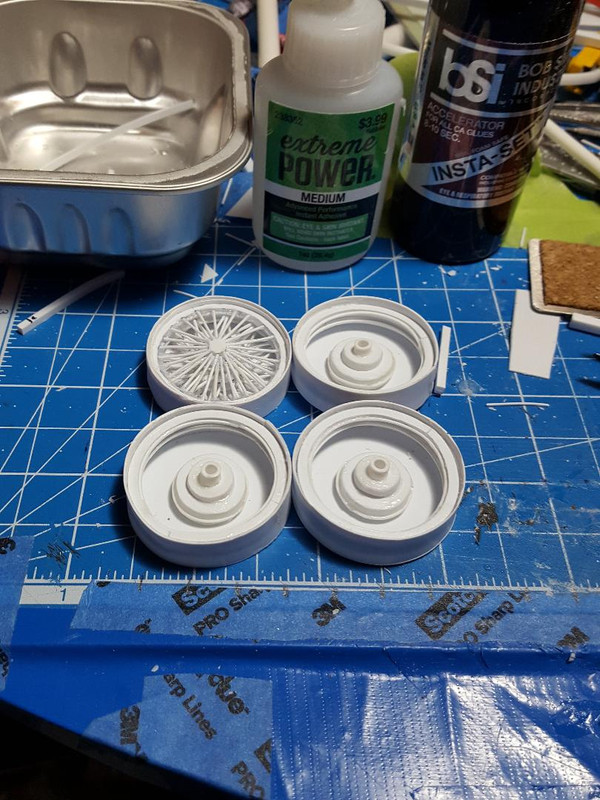

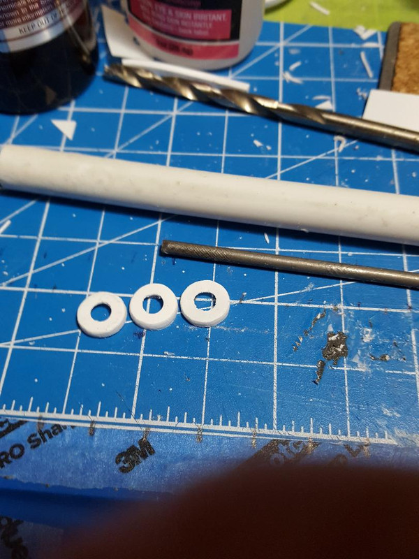

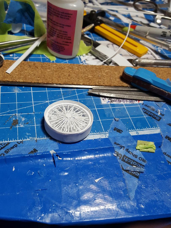

Thanks 76. I'm waiting on some spoke rods I ordered so I will soon start making the tires till I get the spoke rods.

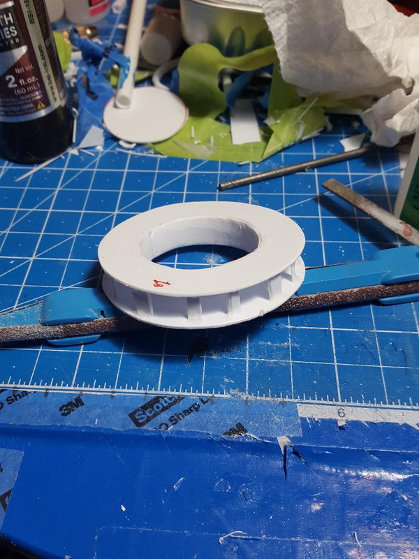

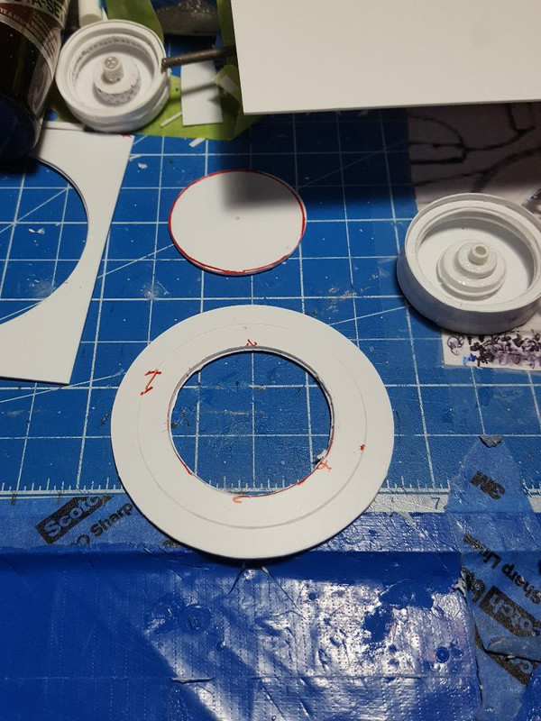

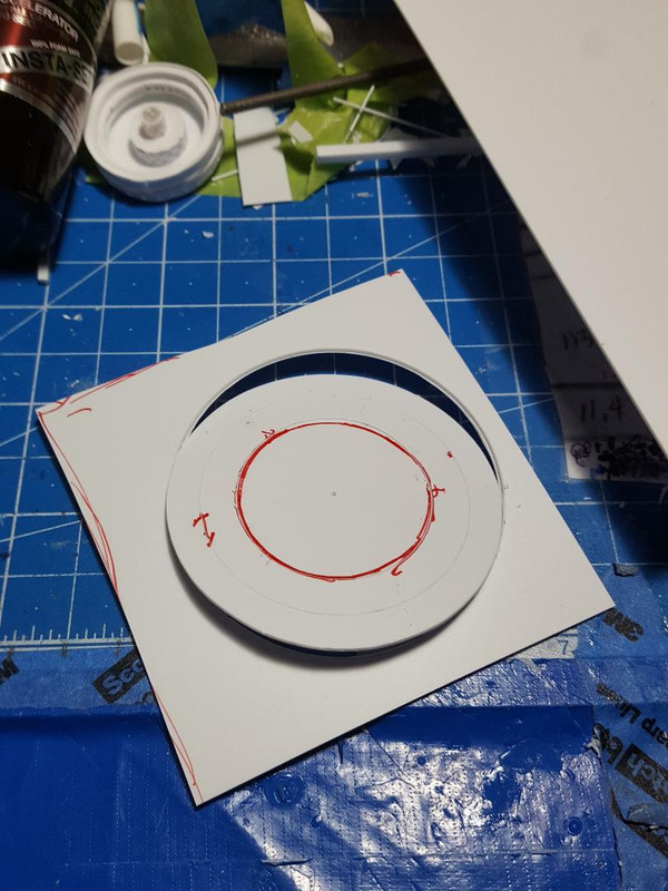

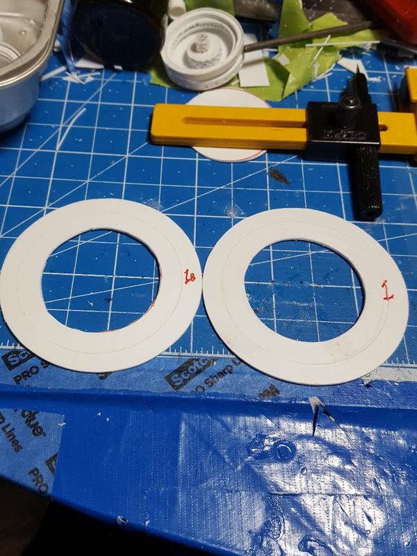

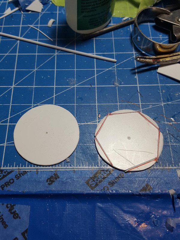

Got started on the tires. Tedious work using the cutting compass.
How will you make the tires Mark? By stacking layers then sanding? I'm really enjoying this. I was thoroughly impressed when you did the IROC Camaro building most of your own parts. This completely scratch building everything is on a whole other level.
Quote from: Volzfan59 on January 13, 2026, 09:34:34 AMHow will you make the tires Mark? By stacking layers then sanding? I'm really enjoying this. I was thoroughly impressed when you did the IROC Camaro building most of your own parts. This completely scratch building everything is on a whole other level.

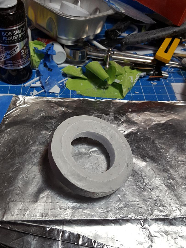

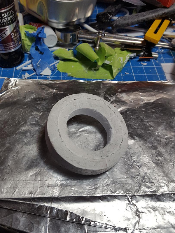

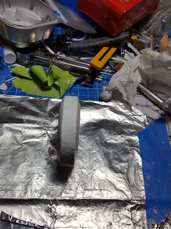

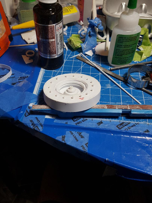

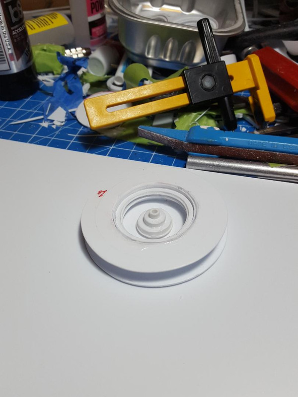

Thanks, Steve. What you see here is the inside and outside of the tire. I will make an inner and outer belt to connect the two of them so the tire will actually be hollow. I will strengthen the sides with rods put through the discs and then put a framework on them to fill with epoxy putty. I will sand that down to make the tires round on the outside. It will all come clear eventually how I'm going to do it.
I thought I would need to add the little wedge pieces to the sides of the tire, but that work is such a time waster that I believe all I need is the radius wall in the middle of the sides of the tire to fill in with epoxy putty. I will scoop it in place with a plastic spoon.

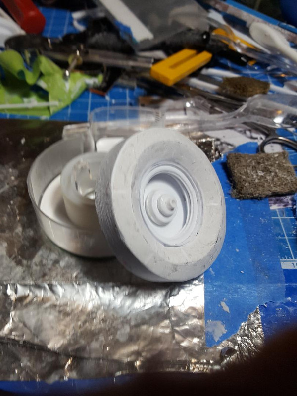

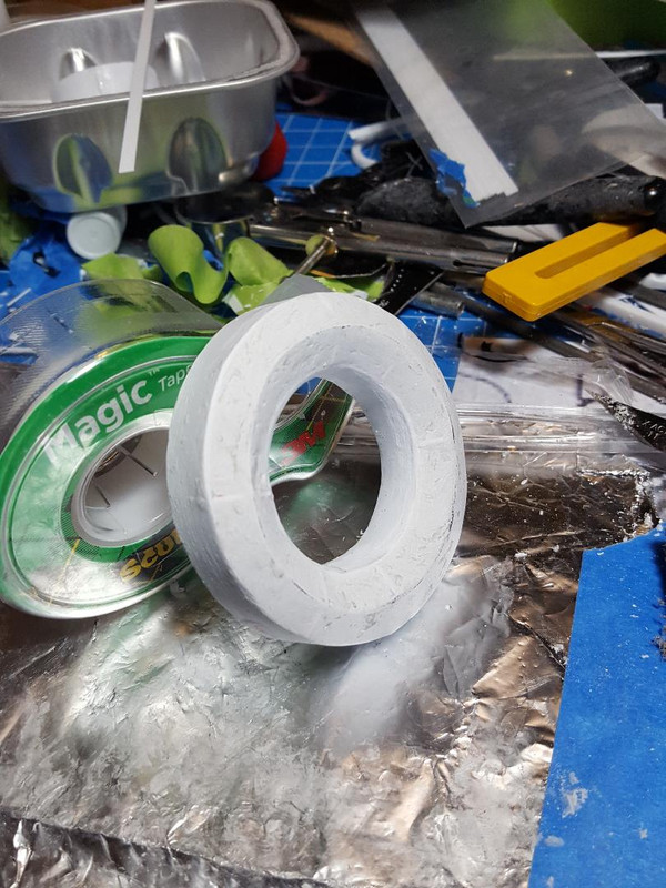

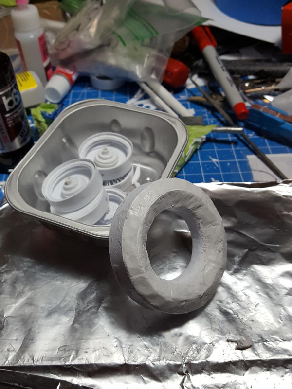

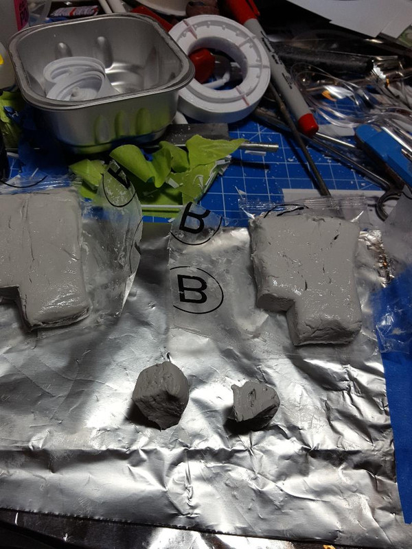

Very happy with the epoxy putty. It cures very hard and is easy to smooth out with a Dremel type tool using a cylinder-shaped course sanding tube. What I have so far looks like a tire and wheel. After painted it wont even look plastic anymore.
Got both sides of the first tire done. Just need to add some regular putty to get the sides totally smooth and add some tread to the surface of the tire using a rasp file. Will roll the tire over the file to leave the imprint of the file that will simulate tire tread.
